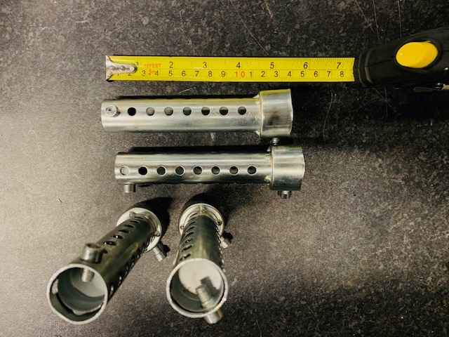

I have found these - £26 for six.
They are 14cm long and on their own don't do much as there are just holes, no baffles, so they need wrapping. The rear bit can be adjusted to restrict it even more, but I'll leave it on the longest setting for now to let as much air though as possible.
I just wonder if performance will suffer ... and if it does, will I notice it??
I will go for the fibreglass option with steel zip ties and post pics and vids of the result - next week probably. Ill also need to drill holes for the retaining screws, and for that the rear wheel has to come out. I have to leave the pipes on as the three sections (down pipe, collector section, rear pipes) are apparently glued together...
