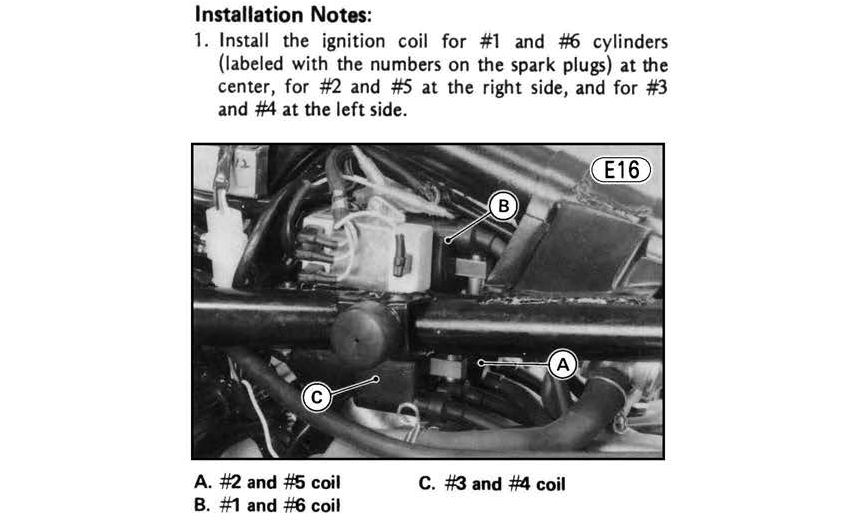

Under normal circumstances according to the manual, you've got the coils mixed up
this is copied out of the manual.
Now with a grain of salt. It is possible that the primary wires to the coils are not in the right place but for now lets just try putting the plug wires on the right coils and feed the right spark plugs and see what happens.
