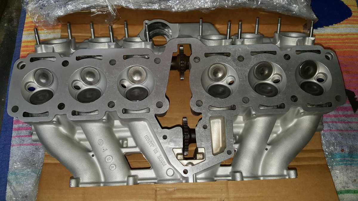

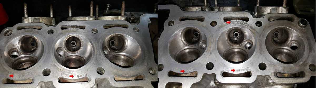

Got my top-end back at last and would like some tips on aligning the pistons with the cylinder block? I have a plan for the #3 and #4 cylinders but 1, 2, 5 and 6 I am still pondering and I am feeling a bit under qualified at present. I was planning to make piston ring compressors from split pvc pipes and clamps (I think Pete may have given me this idea). As usual all tips and comments are welcome.
Anyway here are photos of the before and after of the head.
