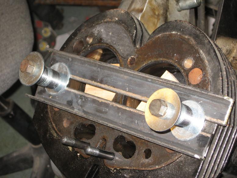

Thanks for the tips gentlemen. With instilled confidence I have successfully removed the timing chain and water pump drive shaft. A new educational opportunity now exists for me to remove the cylinder block as it won't budge. All pistons move freely and I have removed the 4 bolts that reside underneath the intake manifold (when engine is assembled). So I tried the rubber mallet technique with no luck and was wondering the next best technique to try. Plenty of google research is always done before I hit the forum up for insights and some of the suggestions from my google searches I flat-out just don't understand and the ones I do understand I was hoping to get some feedback on.
Heating with a blow torch?
Single head razor blades around the base gasket?
Cut two blocks of 3/4" wood to fit inside the cylinders, on top of the pistons. Bolt a bar across the cylinders with the head bolts. Then gently turn the crank so that the pistons push the blocks into the bar, and it will lift the cylinders right off?
