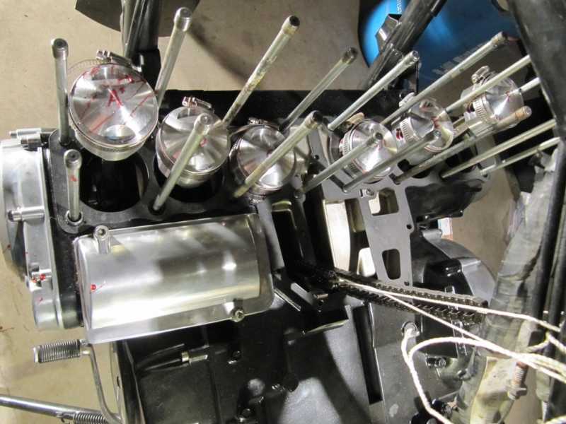

When you put everything back together, run zip ties on the piston rings to compress them. Getting the bores on is still a PITA, but it's a lot easier than having to deal with the rings as well.

Someone here can help you with the clearance specs. I used forged pistons so the method of fitment is completely different.
Hose clamps work to hold the rings, large zip ties would do just fine too. I had two other people help me put the cylinder bank over the poisons. It's a very tedious process. You must be very careful our you can break a ring, or even damage a ring groove in the piston... Plan out each step before you do it. Take your time and read this section in the manual several times.

Your mileage may vary on if you want to risk your studs as well, but when my dad helped with mine, he popped a pair of vice grips on a stud, low enough to slip the bores over two of the cylinders, but high enough to clear the two right below it. That way, you don't have to worry about dropping the bores too far, and it's less to worry about.
Also, feel free to drop the cam chain down into the cases while you're doing this. You can fish it out afterward with a magnet, and the way the bottom end is set up, there's no way to lose it. Again, one less thing to worry about.

I had a buddy helping me. We worked the bore down over each side one ring at a time, compressing the rings with our fingers. It was tedious, but ultimately worked.
