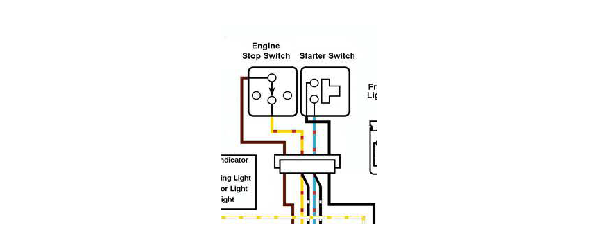

Your ballast resistor question- I was a Chrysler mechanic back in the '70s and the Dodge Chrysler Plymouth vehicles has a 4 pin ballast. 2 of the pins were a high resistance for the "run" aspect of the car and the other 2 pins were the low resistance feed for the "start" position. This gave the coils near battery voltage on start up and when the key was released to the run position, the high resistance gave approximately 8.5 V to the coils when the engine was running. That high resistance feed got extremely hot when running, hence the ceramic block of the resistor. Quite often the high resistor which was a stainless wire would burn out leaving the owner stranded on the side of the road. the car would try to start and when the owner released the key to run, the car would die.
On the Kawasaki- the resistor is in play all the time the ignition switch is on and the engine stop switch is in the run position. Battery voltage is fed through the engine stop switch and feeds the power to the ignition coil and many other circuits.
The switch on the clutch is the "Starter Lock out switch" and it has 2 black wires with white stripes. When the clutch lever is pulled in, that switch is closed and feeds 12 volts to the starter switch.
So, in the diagram-
When the ignition switch is turned on, battery voltage is fed to the brown wire which feeds the engine run/stop switch.
When the engine stop/run switch is placed in the run position, battery voltage from the brown wire feeds the yellow wire with red stripe and also one of the black wires with a white stripe via a junction in the 4 pin connector.
When the clutch lever is pulled the starter lock out switch is closed and feeds voltage from the first black wire /white stripe to the second black wire with a white stripe which is connected to the blue wire/red stripe feeding voltage to the starter switch.
I think at this point maybe recheck your wiring at the 4 pin connector. if it's ok then maybe you have a pinched wire to ground (black/white stripe)

I had another look at the wiring diagram and figured out what probably happened. When you removed the wires from the 6 pin connector and installed the 4 wires you needed in to the 4 pin connector, you crossed the blue wire with red stripe and the yellow wire with the red stripe. In this scenario, the only time the power to the coils and many other circuits would be only when the clutch lever was pulled in.

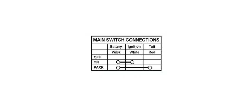

No way it has anything to do with the Main Switch. Short and sweet, the Main Switch is either "Off", "Run" or Park. If the bike will run, it's not the Main Switch.
