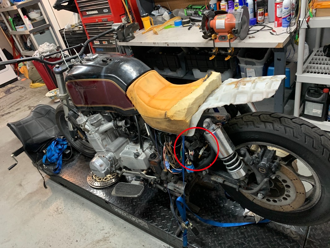

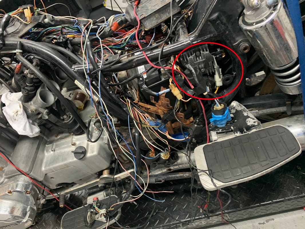

5 years 11 months agoBucko wrote: Thanks Bar. Will check that out. It's the 3 pin connector that is part of the reason why I couldn't find it. Is the "small bracket with two relays " the bracket that is screwed into the frame and also holds the sub R/R?
Yes, this is the one, see pictures
they are not the best but this is what I have
1984 Kawasaki Voyager
2002 Honda CBR954
2002 Honda CBR954
Re: Sub Alternator Connector Location.
Thanks for posting the pictures.
Mystery solved. The 3 pin connector had been replaced with 3 individual bullet connectors that were completely burnt, corroded and welded together. I replaced them with a 4 pin connector as I didn't have any 3 pin in 6.3mm size. Will replace at some point in the future.

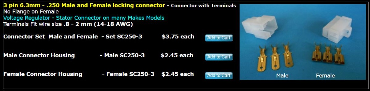

Can you post a close-up picture of the 3 pin connector so I know what to look for in a replacement?. Thanks.

you can check this link I found, look like they have everything
www.cycleterminal.com/250-connectors.html#SC250
below is the 3 pin connector
