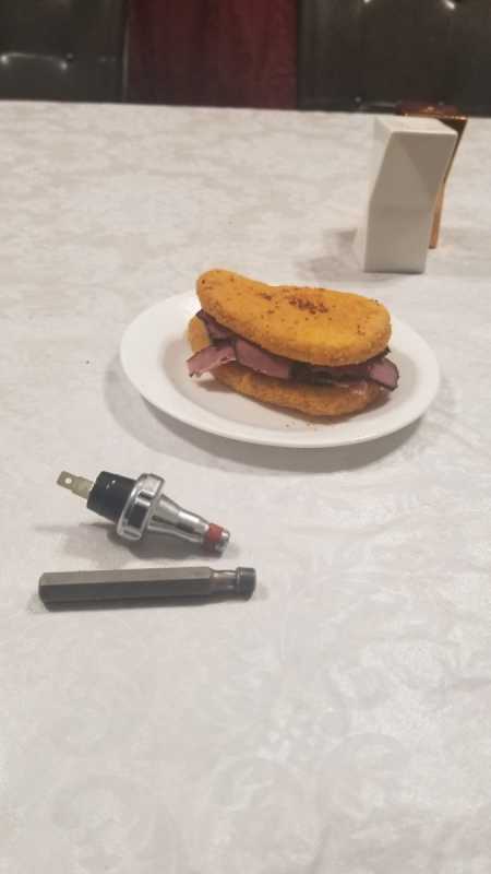

I said the cursing helps get stuck shit out. And it did! Got the plug out!
T40 didnt work. Drilled out to 19/32 for the next size up, spiral screw extractor.
That stripped , but tapping in a T45 did the trick. Only issue now is my 8$ Amazon pressure switch doesnt fit.
Wife seems to have put away my calipers somewhere so I can't measure and see what's wrong.
Tried puting in a 1/8 plug I had laying around and that doesn't fit either. So I'm gonna assume the hole is undersized for some reason. Whatever. Figure it out later...
Pic included for reference. Ran outta bread for victory sandwich so i used some chicken nuggets.
