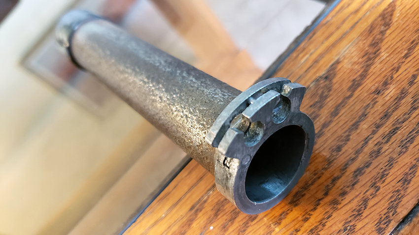

Just got this missing throttle part
(for the still missing right grip) I checked the diameter and it's 25 mm.
So, I think it makes sense that the internal diameters of the grips are left 23 mm and right 24 mm for a tight fit.

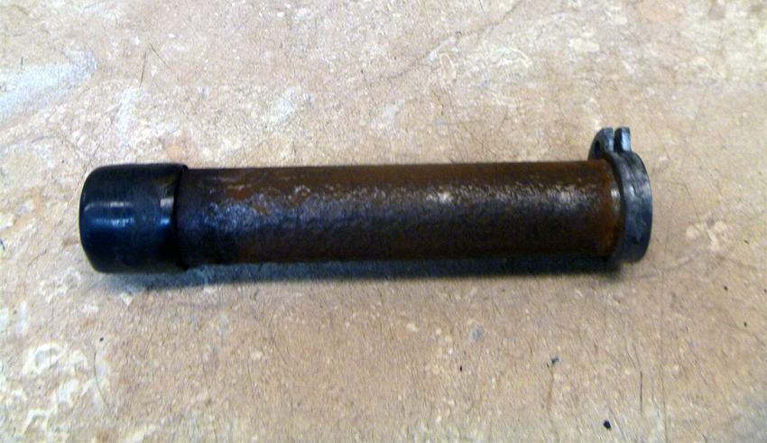

7 years 1 month agozed_thirteen wrote: Most eBay grips I see are 120mm internal length. I think our bikes are 135mm
Question for Stan please- Zed-Thirteen thinks the barrel grips need to be 135 mm in length and you have the throttle barrel in hand so will the 120 mm grips fit or are you needing 135 mm grips?
Re: Handlebar grips
7 years 1 month ago - 7 years 1 month agothe barrel grips need to be 135 mm in length and you have the throttle barrel in hand so will the 120 mm grips fit or are you needing 135 mm grips?
Short answer would be 'no'. But there are a couple scenarios where it potentially would - given the grip is cut open or already open on both ends.
First - perhaps if cruise control is fitted - the grip wouldn't need to go so deep.
Second - the throttle piece came with what looks like stock plastic end plug. 0pen on both ends it would fit.
The throttle tube goes all the way in.

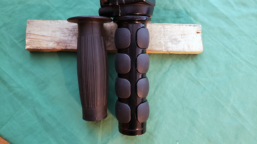

What I did is I had a free 1" aftermarket grips set. As expected, the left one smaller in diameter than the throttle fitting one. And it fit my 7/8" throttle side perfectly!
It looks good and feels good, and I think I will stay with it. The left side - I will figure it out later. For now, the rubber one fits just right and protects the handlebar end well. No rush, nobody knows when this handlebar will rumble.. I will need to find a frame first (wink wink, a reminder if anyone knows.. I'll pay shipping

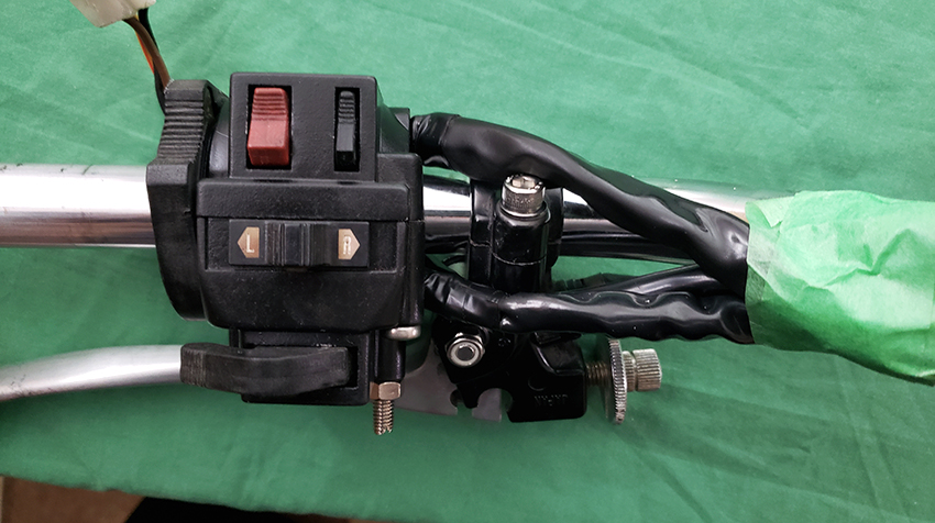

The right electric controls were $25, the throttle tube $9, the grip $0. The controls were stuck, some wires detached. Good cleaning and soldering, now I have a new set! Not a bad deal.
Same with left controls. It took much more to rebuild them as they were in worse shape and they are more complicated. They were very affordable as well, and now I have a new set! Not a bad deal as well.
The only thing to sort out is the bottom screw - the nice stainless shiny one is just to plug the hole for now and so I can remember the thread size.

You don’t want grips quite as long as that throttle barrel.
1. Part of the barrel goes into the right control set
2. You need a slight gap between grip and controls so throttle does not drag
I got this cheap universal set. Resulted in a small gap 5-7mm between grip and controls. I plan on getting a throttle lock so these are perfect for me. Otherwise they would need to be 5mm longer or shorten the throttle barrel.
