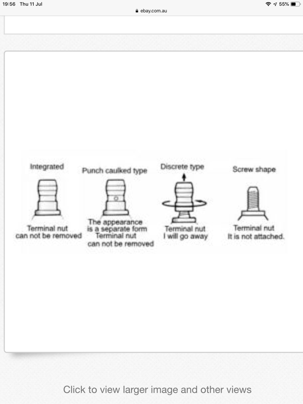

You are correct. The silver ones are made in France and the others are made in Japan. I thought they were counterfeit at first but according to the NGK website they appear to be Ok. Iridium already fitted just have to check the mixture with the colour tune.
