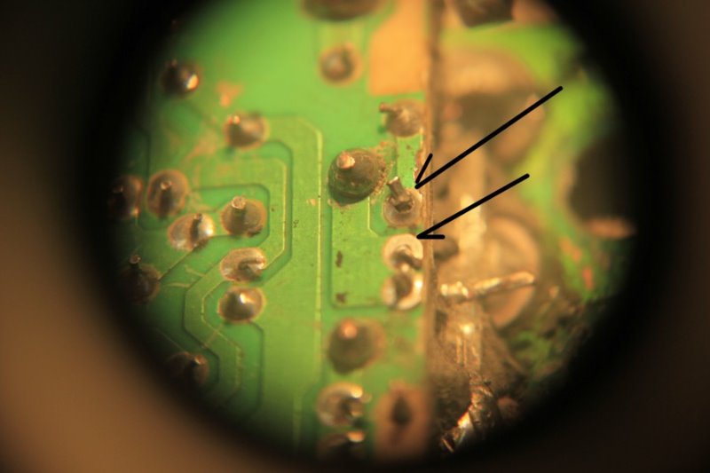

A cold solder joint on one of the diodes. The wire simply lifted-off the pin. Not slamming the manufacturer by any means. I've come across this problem with a number of electronic devices, but was able to rectify (no pun intended) the issue by simply re-soldering. Can't do that in this case. The "potting" material probably helped keep the joint secure for continuity but given the heat expansion it finally lost it's conductivity. That's the theory, anyway.

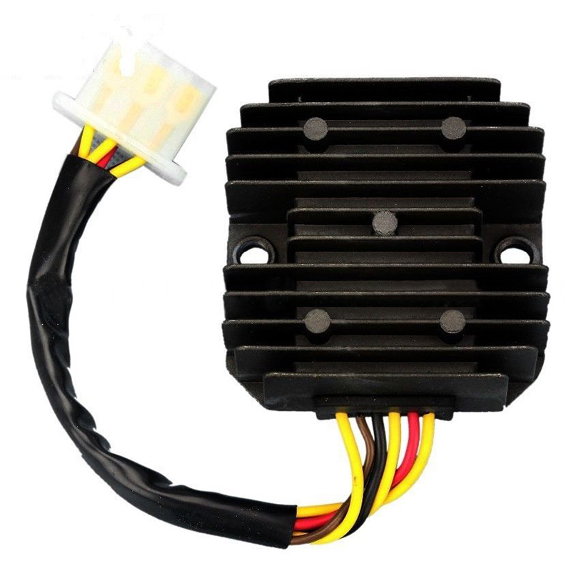

Something else I discovered. The various prices ????? In my search for a new replacement V/R and in researching 80's era Kawasaki's I found that some use the same wiring color-code - 3 yellows, 1 RED, 1 BLACK and 1 BROWN for the 3 phase systems. Of interest to me was the following:
Kawasaki BJ250 (250TR) 2002-2006
Kawasaki BJ250 (ESTRELLA 250) 1992-2006
Kawasaki KZ1000 (POLICE 1000) 1983-2005
Kawasaki KZ1100 1982-1983
Kawasaki GPZ 1100 (ZX1100A2) 1983-1985
Kawasaki GPZ 750 Turbo (ZX750E2) 1984-1985
Model Number: YHC-091
Price:C $19.90
Free shipping
Price:C $19.90
Free shipping

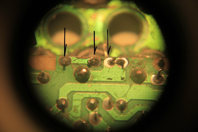

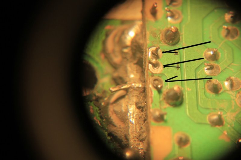

Further to the Cold Solder joint where the solder lifted off the Diode pin, I found these !
ALL BAD joints. This is exactly what I found. I have not "enhanced" the physical appearance of the soldered connections or the photos ! It's clear these components are hand assembled and hand soldered. I've got enough experience to understand how these bad solder-joints happened. NOT enough heat on the "pins". Obviously enough to flow the solder and connect to the printed circuit but not enough to flow and bond to the "pins". And I think it's safe to say," We know where they're made" ! Many aftermarket motorcycle V/R's have the same heat-sink housing. Presumably generic with only the internals made to fit the various applications. This might suggest that they all come from the same source or affiliated source but the concern applies none-the-less. It seems we get what we get (with crossed fingers) and there's no way of assuming their life expectancy until you dig-out the potting material as I did, to discover why the unit failed. I doubt few go to the trouble and I can see why, having to boil-to-soften the potting material numerous times to get to the heart of the problem.

Raises my curiosity Scotch. By chance are these pins on the load side of the regulator? Is it possible that the joints overheated and the solder wiped away in the potting material?

You're correct KB - The bad solder connections are on the Thyristor/Diode connection circuit-board. It's very obvious there has been some heating on these pins and I suspect that the heating expansion along with a cold-joint to begin with, created the complete separation on one of the diode pins and has caused cracking around the other 4. However: Boiling the unit to soften the potting material did not melt the solder. Not hot enough and no traces/indication of solder melting; but your idea is valid. I'm quite disgusted with the very poor quality of the Solder-joints. Clearly inexperienced workmanship (not enough heat to the "pin" when soldering) probably combined with a "filling the quota" mentality for the production day. (Or it was the last one assembled on a Friday?)
