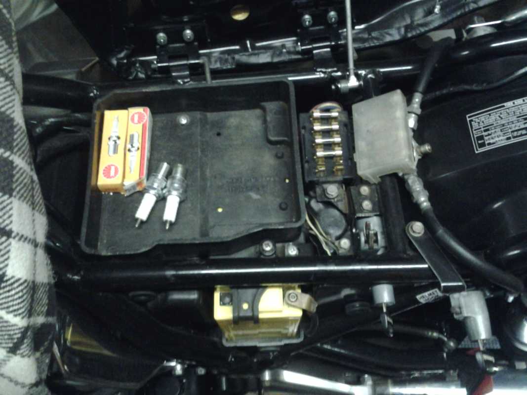

So, i went to start checking through the big Zed today, hooked up a charged battery (pillaged from CBX) turned the key and absolutely nothing works apart from the hazard warning lights.
l have the tank, seat, side panels and headlight off, i have checked all the wiring blocks i can see and there are none that are disconnected. none of the fuses above the battery look blown
The key works in the seat and works in the ignition,it turns and ''clicks'' round, but you can pull it out at any stage, i looks like someone might have had a go at it with a screw driver at some stage.........
So, Gents, anyone have had this happen, or any idea where to start looking for the fault/s?

seat switch in correct position to start it ??, also is the clutch lever safety switch still hooked up ?, pull the clutch in to start ... do neutral and oil lights come on ??

Yes, from starting all the way to the left past 'off' and to 'on' (park or lock, cannot remember which one
, no neutral light, oil light, headlight, rear light absolutely nothing apart from the hazards running the indicators and the direction indicators in the gauge console work
Didnt think about pulling the clutch in will try that

10 years 10 months agoanyoldiron wrote: Yes, from starting all the way to the left past 'off' and to 'on' (park or lock, cannot remember which one, no neutral light, oil light, headlight, rear light absolutely nothing apart from the hazards running the indicators and the direction indicators in the gauge console work

Check the feed to and through the main fuse. The hazards are the only circuit not going through this fuse, so if you have hazards and nothing else, I suspect the feed through the main.

Electrickery, my Achilles heel! l have the wiring diagram, but can you give me a idea of where it is and what it looks like (1979 KZ1300)?
Cheers
