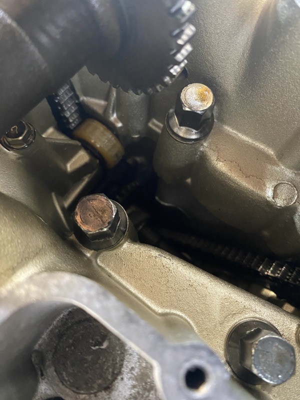

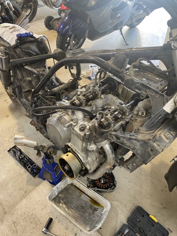

The Cycle World article certainly catches the flavour of the bike very well. Sure is a lot of old touring bikes of the 80's and 90's for sale right now . Time of the year to get ready for winter , riding season just about over for many , the social media sites are awash with bikes. Don't find any KZ"s tho.
A few hours more work and I'll have the engine out.
Idler gear badly worn.

So, what's the plan?? Pull the engine and.........
A timely catch with that gear. Somebody got the mileage out of that one. Is there a Liska gear in her future??
