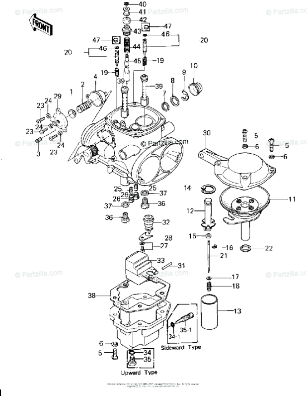

I tend to go off in to analytical spurts when working through a problem so here I go-The “situation” here is black deposits on the spark plugs after running for a couple of hundred miles that starts to cause misfiring. The black deposits are dry I assume since a wire brush will clean up the plugs and the misfiring stops. My conclusion here would be that the engine is running fuel rich and the black deposits are carbon from unburned fuel. Had the deposits been black, wet and shiny, a wire brush would not clean them off to the point that misfiring stopped. Black, wet, shiny deposits would be an oil consumption problem.

Needle jets with plugged emulsion ports (item #39 in diagram). There are 16 emulsion ports in each needle that are roughly .010” in diameter. These ports allow air in to the needle jets to help break up the droplets of fuel before the fuel enters to carb throat. If the ports are plugged, more fuel will be pulled in to the carb throat and cause rich running. I doubt that most of the members on the site who decided to overhaul their carbs actually pulled out the needle jets and had a good look at them. To remove, you need to remove the main jets and brass washer, and have the piston valves (item #13) removed, then push the needle jets out through the carb throats (towards the top of the carb). All 6 of my needle jets had numerous ports plugged completely with the white oxide. I had to run number drill bits through the holes to clean out then I also used Autosol metal polish to clean the jets up to an as new appearance. Be careful not to open up the emulsion ports beyond original size.
Enrichment Valve seized in the carb body. The Enrichment Valve works in conjunction with the Low-Speed Circuit and sends a rich mixture down the intake ports under deacceleration. I experienced 3 stuck enrichment valves on my 3 carburetors. Scotch came up with a mod to eliminate the Enrichment System and has had great results. Consider doing the mod.
