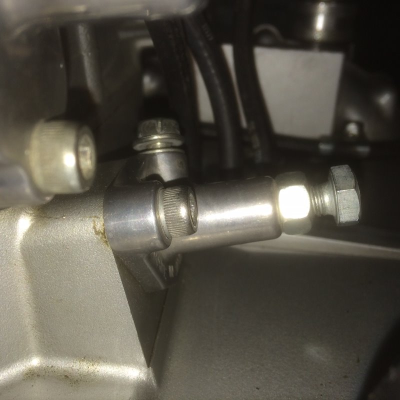

9 years 5 months ago - 9 years 5 months agoscotch wrote: The photo should help qualify the mod to the OEM tensioner. What can't be seen is the "Internal" nut that's immediately opposite the exterior lock-nut. The internal nut was "rounded" to fit snuggly in the very end of the bore in the tail-piece of the adjuster. There's more, but I'm not going to complicate this further, at this point. Hope this helps somewhat.
Thanks Scotch - it mostly makes sense. I'm trying to figure out what the little bolt on the backside of the tensioner does? And so there's actually a nut you machined that goes into the thread area just past where the exterior lock nut is seen in the photo? And sorry for asking, but what is the necessity behind that internal nut? The exterior one alone is insufficient maybe ..
