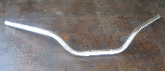

Dang, had to find a tape with inches on it to measure mine, we're metric down under :-), ok the "original" ones I have off the bike at present are 28 inches across from tip to tip, and holding them against a flat surface they have a 5 inch sweep back, so these are a tad different to yours, wonder why ?, they look right for the bike, will have to check into this a bit more. Do you have to have a longer clutch cable and front brake line to make the distance, or are the standard ones ok ??

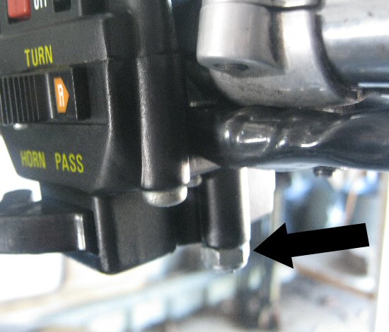

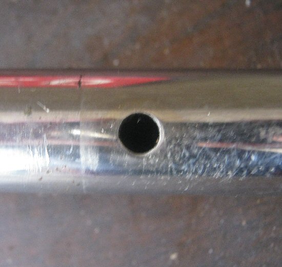

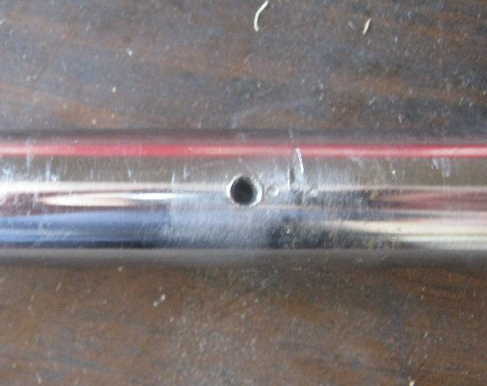

the left hand side has a small hole underneath, for the lock screw of the left box, don't know if this was done originally or was done by someone else, this is getting interesting, so many differences, I guess the Voyager type bars might be different again ??, wonder if there is just a "standard" type ?
Left hand hole under bars
Right hand hole on top of bars
Locator screw on left hand box
bars I have off at present

Wonder if my bars are part No 46003-1040 (semi - low) ??, would explain the difference in measurements ???
