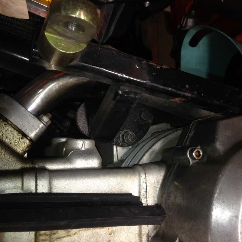

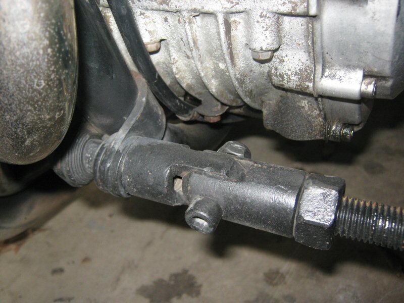

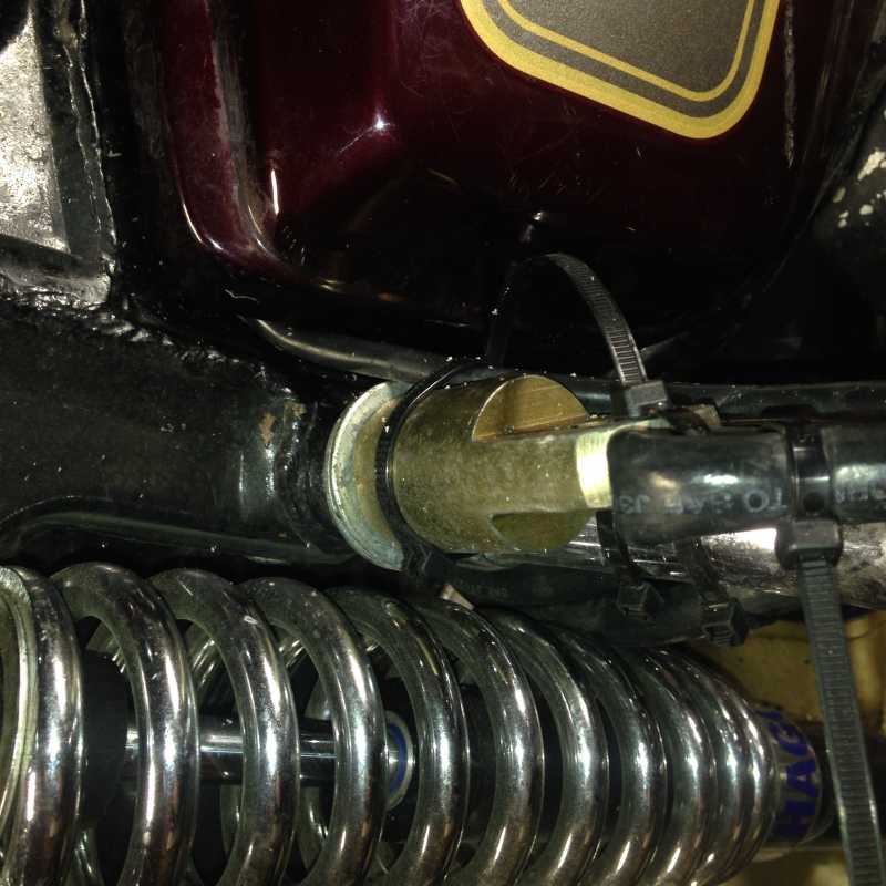

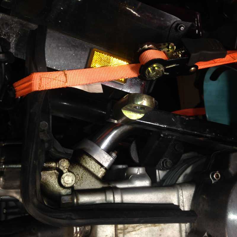

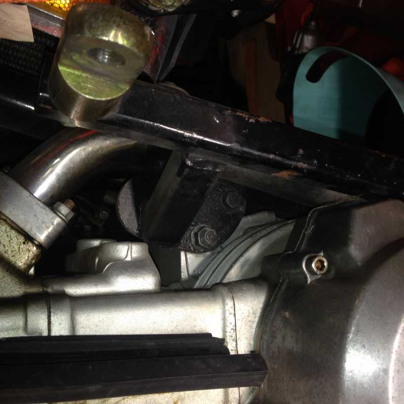

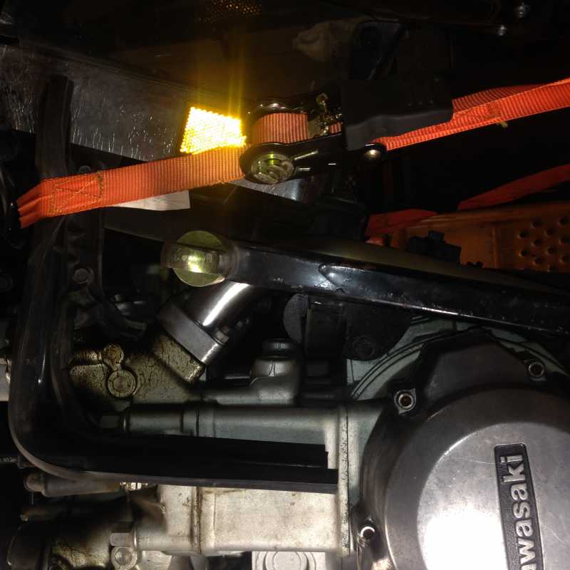

hi trikebldr, here are some pics of the bike side mounts. the front mounts are on a subframe mounted to the left and right down tubes and the eng. mounts.be carefull not to distort the frame down tubes with the clamps.the rear lower is mounted to the rear foot rest and the rear upper is mounted to upper bag guard mount. the bolt size for these clevis eyes are 1/2 inch.you can probably buy all of this from motorvation to fit your specific bike. building your own would be very easy too.if you need pics of the car mounted i will probably have it back on in a couple of days. hope this helps.sorry if these turn up sideways. rick says an i phone does that. and i dont know enough to correct it. good luck pat.

Oh, WOW! Thank you Pat. At first it looked like you had hoisted the bike up by it's front wheel, but then I remembered your camera rotates the pic. It's easy to download them and rotate them back.
The rear mounts are almost exactly how I had planned, especially the upper mount. The running board bracket has an unused hole toward the rear, and low, that I might be using, but the bracket is an aluminum casting and not strong enough so I have fabricated a 1/2" steel structure to fit behind it to support it and the mount. It will push the bracket out from the frame 1/2", but that is hardly noticeable. Your pics have changed my mind about using that unused hole, though. I like how yours is directly mounted into a frame boss. Just a slight modification to one of those screw in clevises to fit into the recessed bolt hole.
The front mounts were my concern. On my '83 I actually Tig welded the front upper mount to the frame rail so the strut just disappeared into the fairing through those vents. This time I had sort of planned a modified right crash bar with the lower mount incorporated into it. Those crash bars are fairly rugged and mount at three points, and with some gussets would be plenty strong enough.
You are absolutely right about being careful not to damage the frame with those clamps! It is so easy to crush the tubing if not careful. I noticed your sub-frame used narrow u-bolts. Motorvation uses wide u-straps to clamp around a frame tube. Did they install your car?
My initial idea was to create a total sub-frame using the center stand mounts at the rear and clamps around the front frame section to make a four-point attachment. Much easier said than done. I prefer to not modify this bike at all like I did on my '83 years ago. I have also bought a replacement right crash guard for the front to modify and re-chrome with the lower front mount so my original, perfect guard is left alone. The upper front attachment is my only remaining hurdle, and I think your pics just gave me some ideas to check out so I don't have to weld anything to the frame.

bruce, thismount up is what motorvation supplied for the 86 voyager. when you are building your mount up the most important part is to get the 2 lower mounts the same height from the floor.if not , when you change your lean angle it will change toe in. jay @ dmc sidecars is a very good source for set up info.you can usually get all the help you can stand at the usca website. lots of good folks there. good luck pat

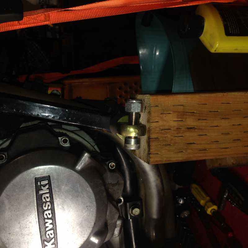

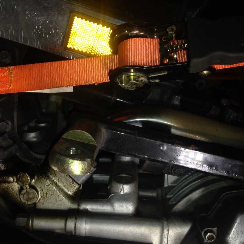

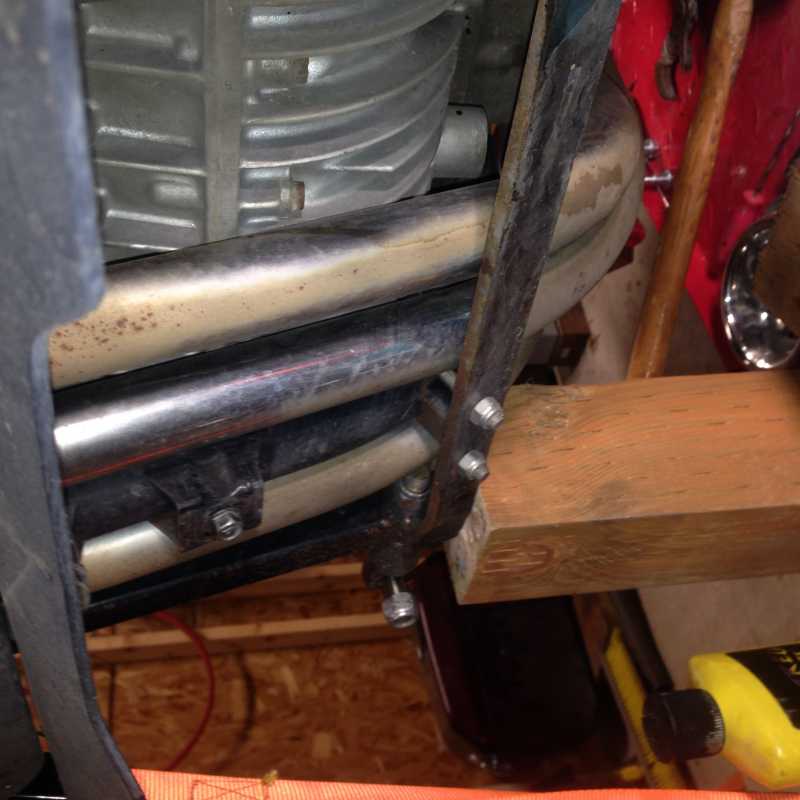

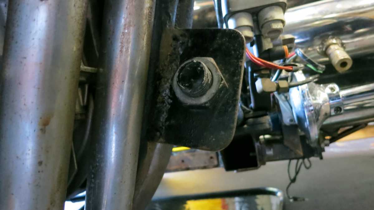

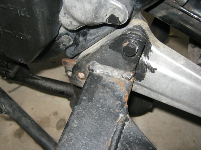

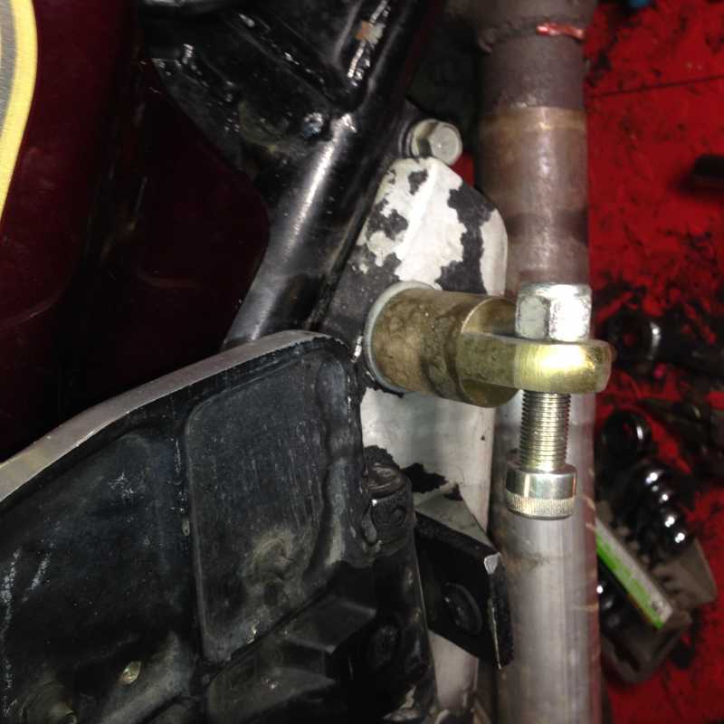

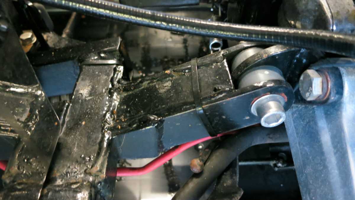

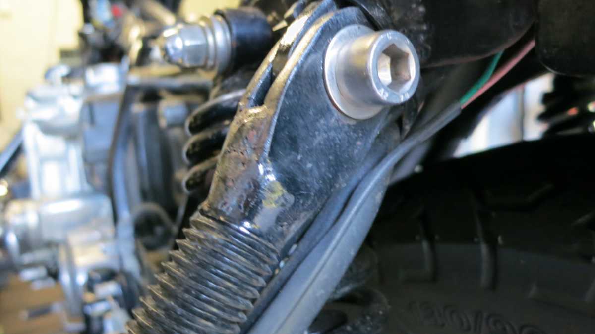

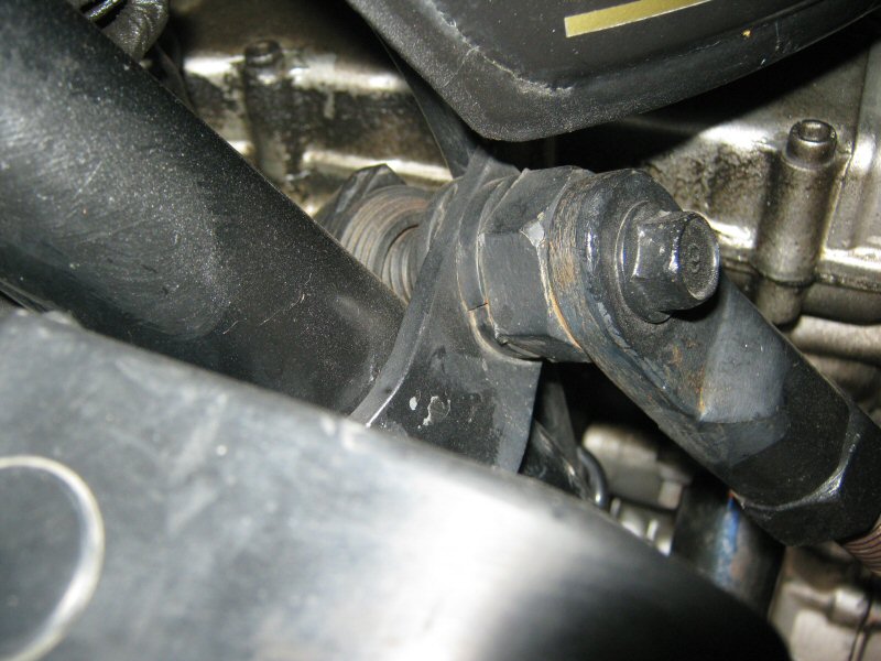

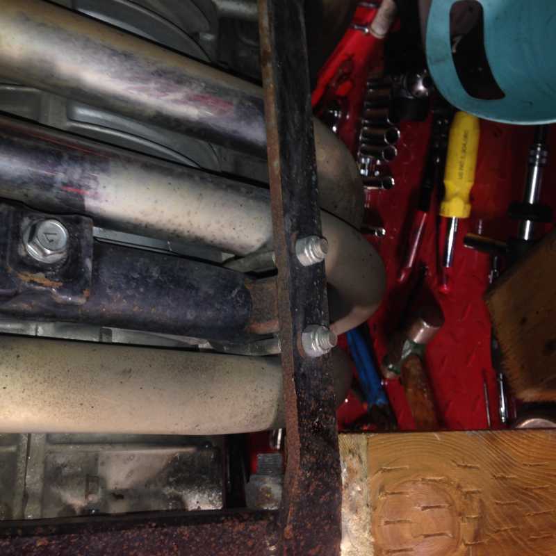

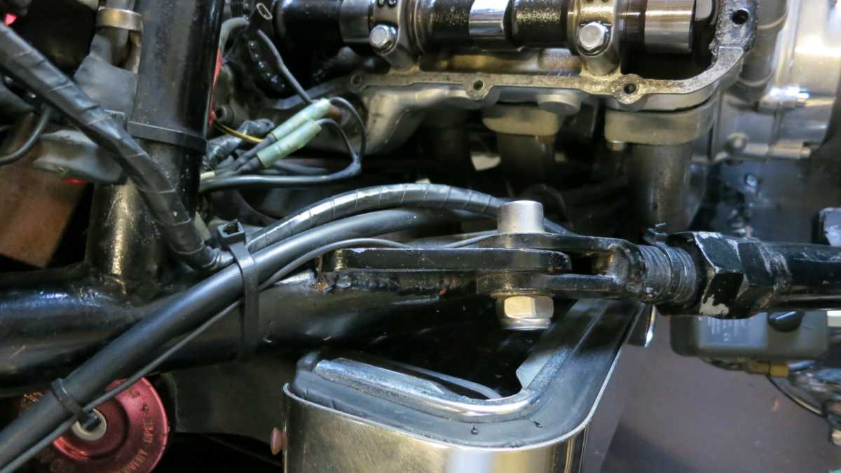

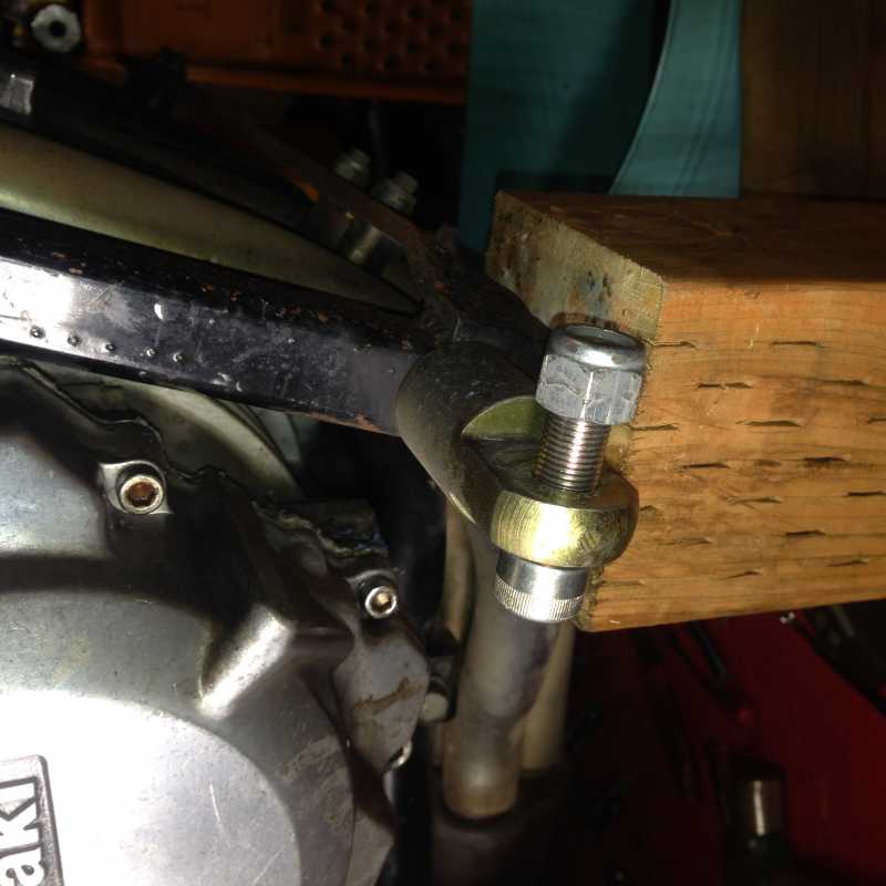

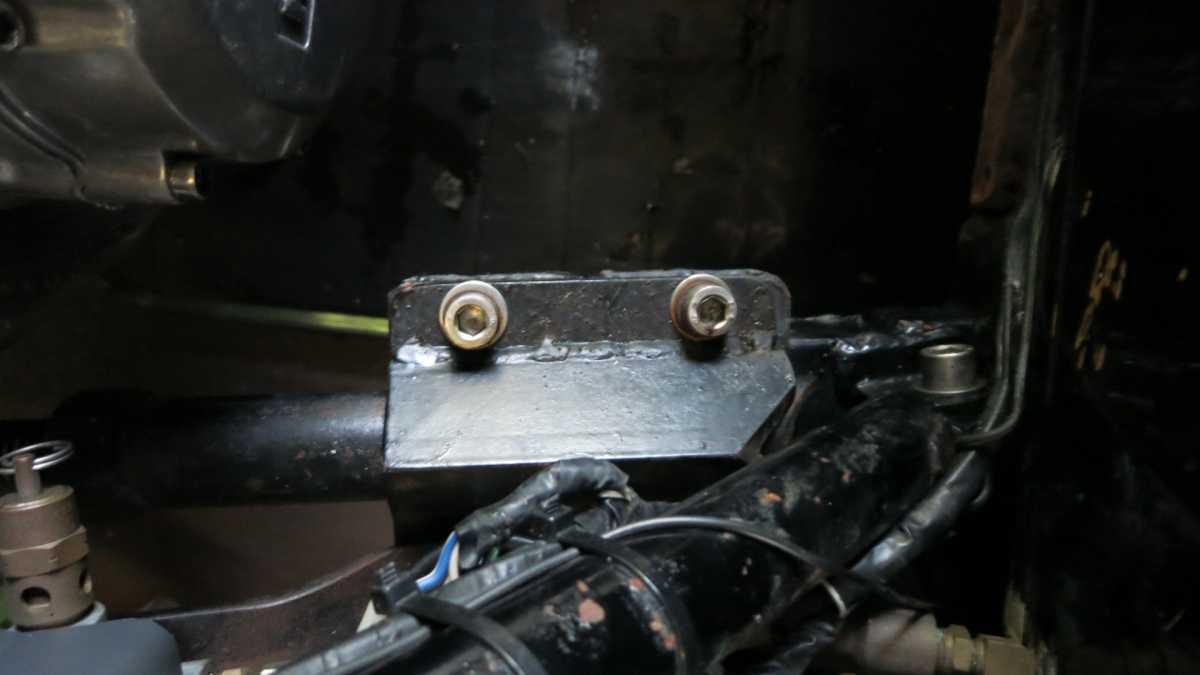

Here are closeups of my sidecar mounts. Hope it helps someone.
Lower Rear
Upper Rear
Lower Front
Upper Front
Lower Rear
Upper Rear
Lower Front
Upper Front

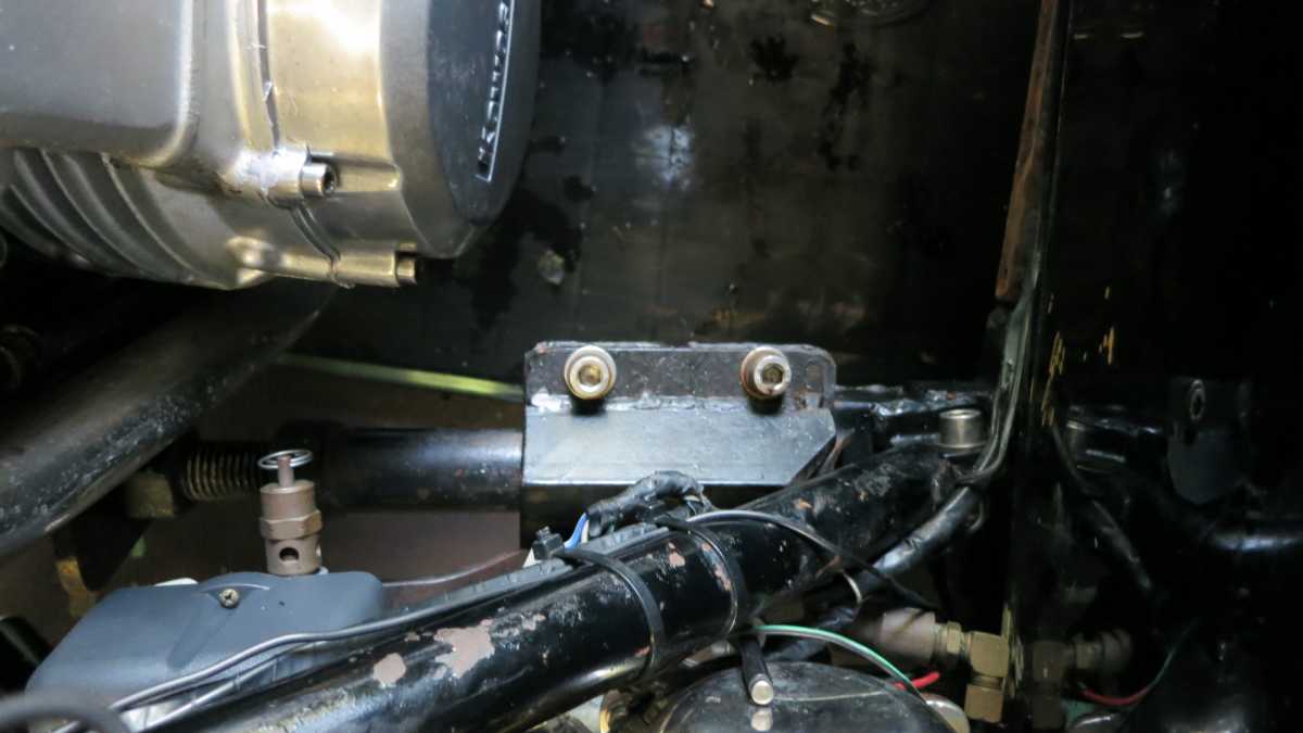

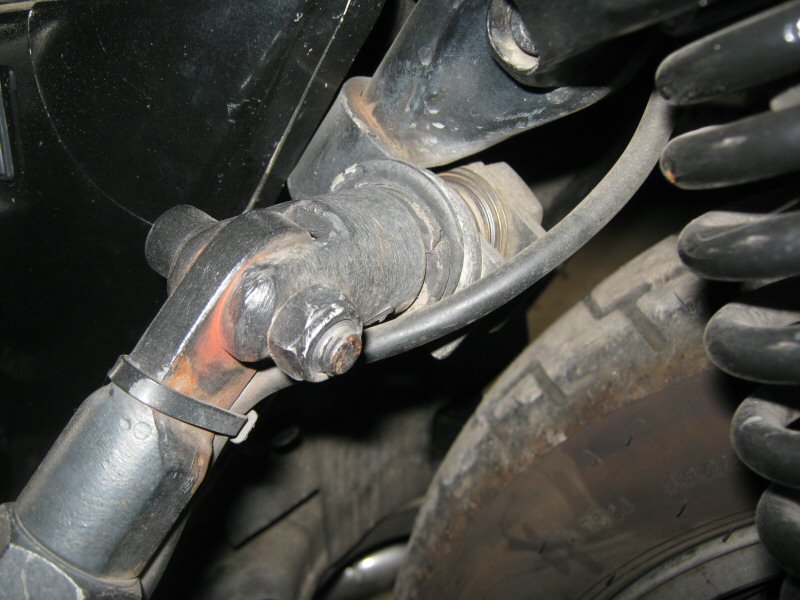

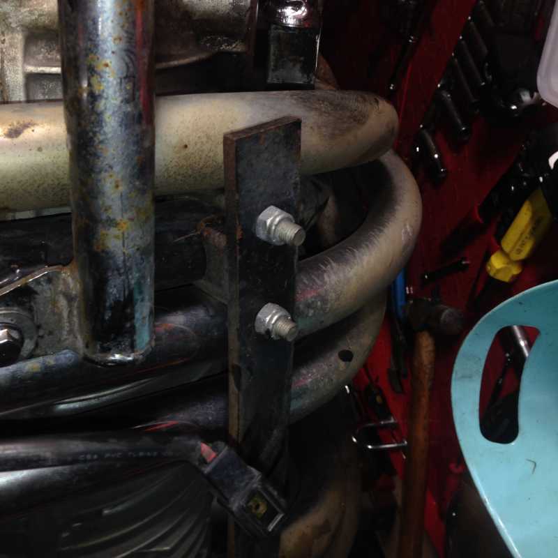

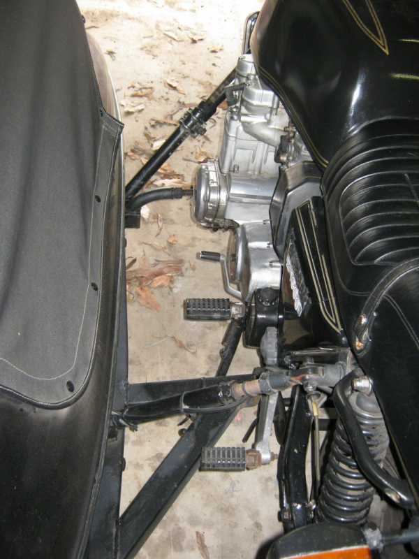

Well thought i'd post some mount pics of mine, it's on the wrong side for you but anyway thank goodness I decided to take the photos, found a broken bolt, have to fix that, wonder how long it's been like that ???, anyway here's how DJP in Australia mounted their sidecars, then a few modifications to get rid of the quick release ball couplings, cheers Pete.
