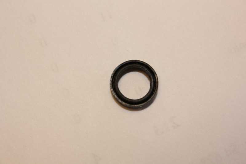

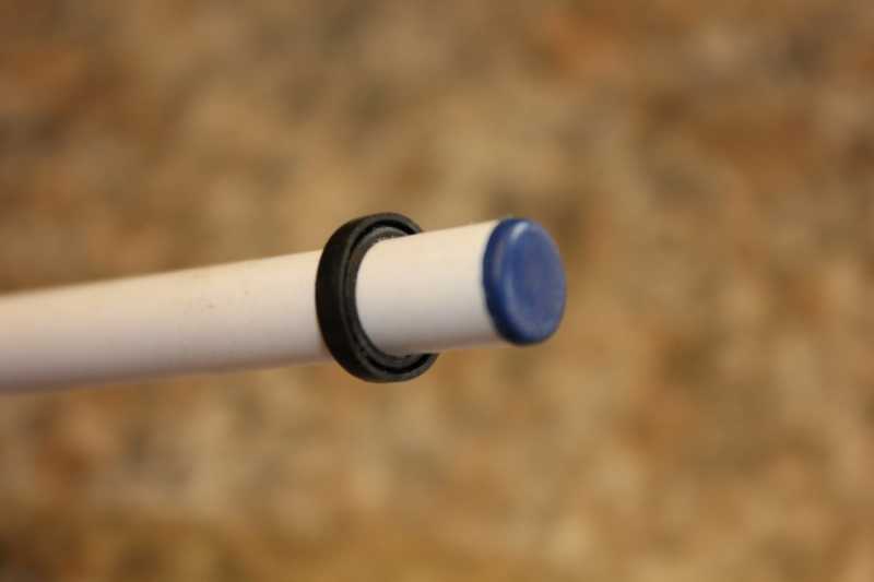

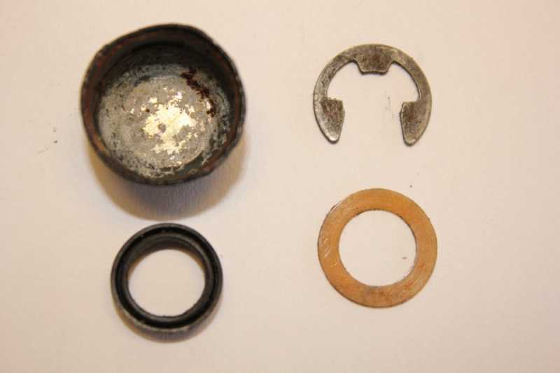

This is what the throttle shaft seal looks like. It is in fact a seal as opposed to an "o-ring". I'd call it a "quad-ring" due to it's square shape (4 sides). In this case (my bench-carb) the seal fit snugly on the shaft but it had shrunk away from the bore. The throttle shafts can traverse .022" (measured) when the throttle plates are opened. The dust-cap came off easily with a flat-bladed screw driver placed under the cap edge with a prying up motion. Like a bottle-cap.
Replacing this seal is very easy on the "capped" end but the throttle plates would require dis-assembly and the shaft removed to replace the seal on the "linkage' end.
I'm of the personal opinion that the latter would be the last procedure on any list of carb work. The need to remove the throttle-shaft to replace the seal on the "linkage" end would be best determined if serious problems arose from the carbs not holding a sync., not holding a consistent idle or other unexplained anomaly's. But again: my opinion.
I found this on the topic: "Keihin carb end bushing leak" and there are a few more articles on the subject ! This may be an area of carb maintenance which deserves more attention and respect.
I'm going to look into this further !

On both the '79 (currently on the bike) and the '80 carbs I removed the caps which cover the cir-clipped end of the throttle shaft (only on #1 and #3 carbs - no room for cap on #2 carb) and placed a drop of oil in the bore, then replaced the seal/washer &clip. Then I used a small amount of gasket seal on the inside mating edge of each cap and installed the caps.
The theory: This will seal the cap to the shaft-boss regardless of the rubber seal. Whereas the "linkage" end seal can not be accessed, I placed a drop of machine oil on the inside and outside of each shaft. The lubrication factor is obvious and the oil may migrate and "rejuvenate" the inaccessible seal.

For those that don't know me I can't leave well enough alone. I've always torn things apart to understand how it was designed/built. I had to pull the throttle shaft to see if there was a seal underneath the throttle return spring and there is. On the carb I just took apart, the throttle shaft on the outboard end had the anodizing worn off on the engine side and the seal was in good shape. The spring end of the shaft was like new but the seal was shot. It had no elasticity and was shrunk as if the entire seal was about 2/3's the original width. It was spinning on the shaft, and loose in the bore. This may have happened from some kind of cleaning solvent somewhere along the life span of this motorcycle. I suspect the outboard seal was saved by the steel cap over the end of the shaft. These seals are definitely U-cup seals.
I've got all the orings and seals out now and I plan on sizing them up and going to Parker Hannifan and getting replacements made of Viton 75 durometer.
