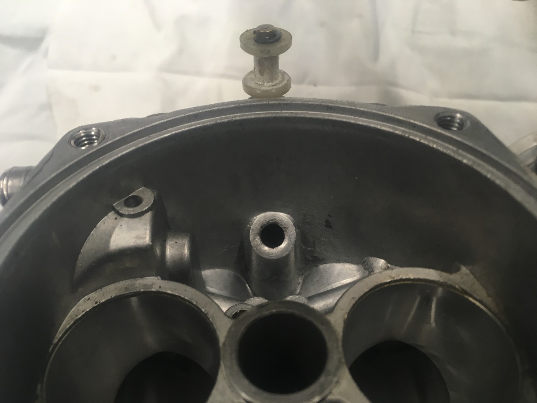

Re: Cold Start Problems
2 years 3 months ago - 2 years 3 months ago
Last edit: 2 years 3 months ago by scotch.

Scotch’s carb mod fixed that problem for many of us.
Also, putting the fuel tap to prime and listen to the carbs filling with fuel before hitting the start button.

Scotch's carb mod is very interesting and worth noting should the problem re appear.
