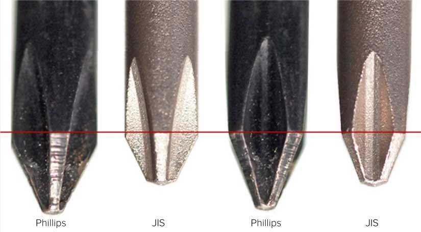

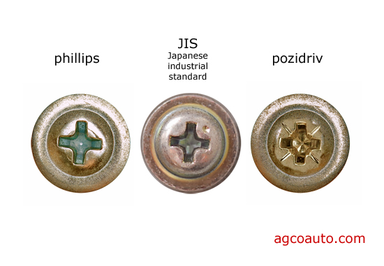

Also, this is a good opportunity to point out that the "screws" including the ones you're talking about are JIS screws (Japanese Industrial Standard ) screws and not Philip head screws. They take a specific screwdriver to fit the cross slot. If you haven't got a set of JIS screwdrivers, spend the money and get a set. You won't regret it.
JIS screws have an indication on the head of the screw that looks like a pin punch mark to indicate that they are JIS screws. Philip head screwdrivers will almost fit JIS screws but seem a little sloppy in the head of the screw and a JIS screwdriver in a Philip head screw seem s little tight. It's a small difference but when you're trying to remove tight or frozen screws, it makes all the difference in the world. The reason you have bitched screws on those butterflies is because someone else tried to remove those screws with a Philip screwdriver and mashed the head. Had they used a JIS driver, the JIS driver would have turned out the screws even after they had been peened. When you have the proper tools for the job, the job goes easy. I had carb rebuild training as part of my apprenticeship for auto mechanic and it is a skill that most backyard mechanics don't recognize and unfortunately, you are the victim here of what happens when somebody tackles a job without the experience or training.
My advice for you at this point would be to leave the butterflies alone and not worry about removing them for cleaning or seal replacement. Attempting to drill out the screw heads will not release the butterflies that are pinched in the slot of the shafts so that means that you would have to drill the screw out completely in order to remove the butterflies. That would mean tapping the shafts for the next size up which would weaken the shaft. ( I hope I've made my point here)

I will get myself set of JIS screw drivers. For the other work I had ground down standard drivers for a tight fit which has worked on the larger items.
I will take your advice on the butterfly valves too.

Incase you dont know.............the screwdrivers in your Kawasaki Tool Kit are all JIS.
I have a 30 year old one in my tool kit with a T BAR welded on the top for better grip..............never NOT managed to get a JIS Screw out with it !
