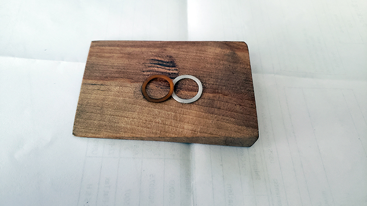

I can send you replacements. They are derlin and exact measurements. Derlin is the right modern material for this kind of applications. The outside diameter I cut by hand, and I make it accurate. The outside diameter does not need precision anyway - thickness and inside diameter are important. 0nce I find someone to machine the whole batch to the 17 mm outside they will be all exactly the same. But like I said, it doesn't really matter, but for sure better than using scissors every time!
I can send 3 + 1 spare for $2 plus postage (envelope). PM me if you want them.
