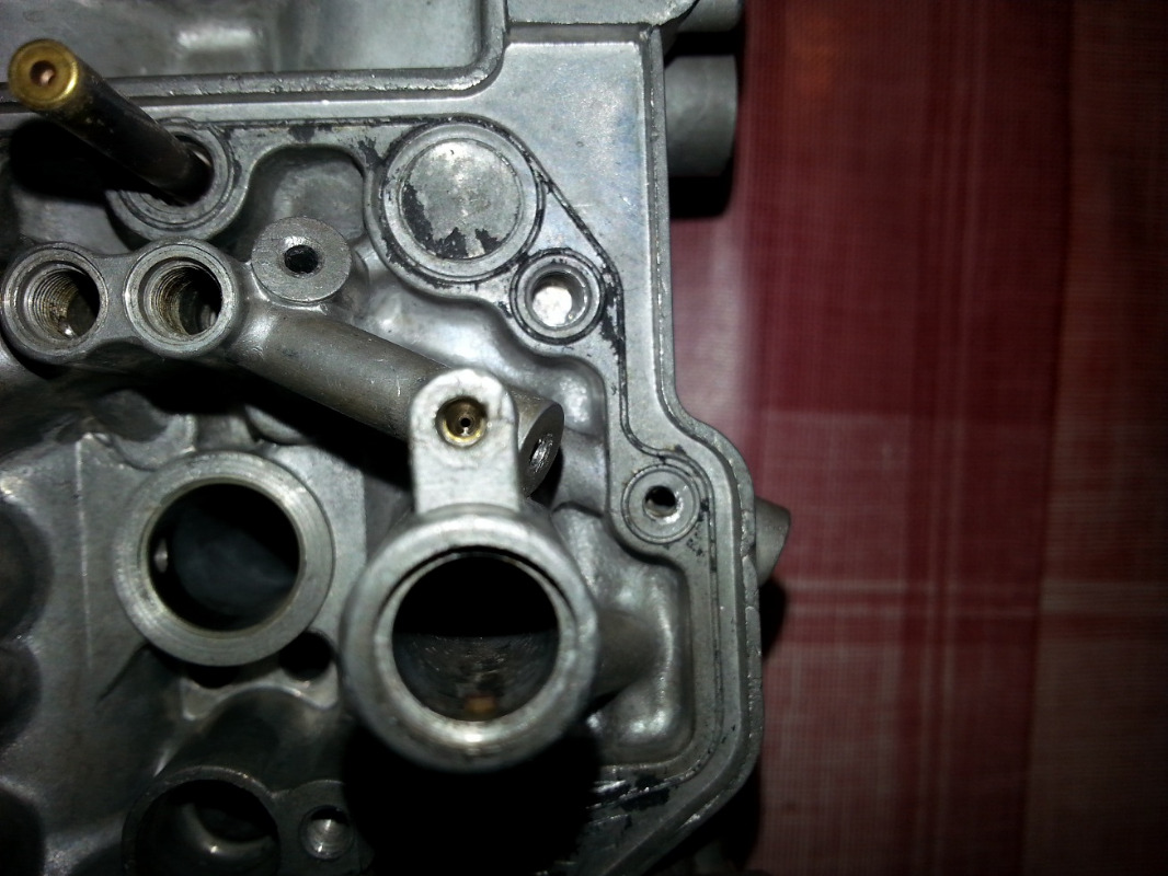

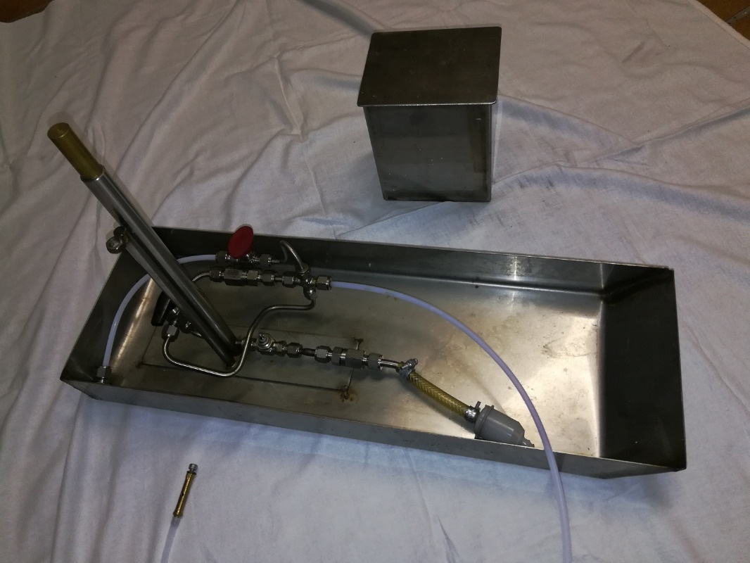

First obviously disassembly, cleaning, boiling it in distilled water (don't use normal water to boil, it will leave nasty scale stain on and inside of the carb), flushing, blowing with air. I have build cleaning pump, it can move the liquid (fuel, thinner) for and backwards and also I can supply the air in to the system, this because I find that air bubbles help to break off the rust stain or particles in some of more troublesome areas of the carburetor.
And also prior to flushing I soak them for about 20 minutes in Tangit, [(don't spill it, it will burn hole in you lawn, or in the garage floor, also if you take it too long it will start to dissolve the brass gallery pin seal ] to remove some of the stain in the galleries, than I blow the passages with probably enough air to supply the whole planet. After I clean them thoroughly I drunk one bear, and than I started all over again, just in case. You could skip the step with the beer if you want, but I really don't recommend this. For soaking in Tangit, I have removed all the jets, everything else including the butterfly valve and seals, ONLY carburetor body and brass gallery inserts (once I even drill them all out to see what's behind, picture later) remain, any plastic or rubber parts would have dissolve instantly otherwise.

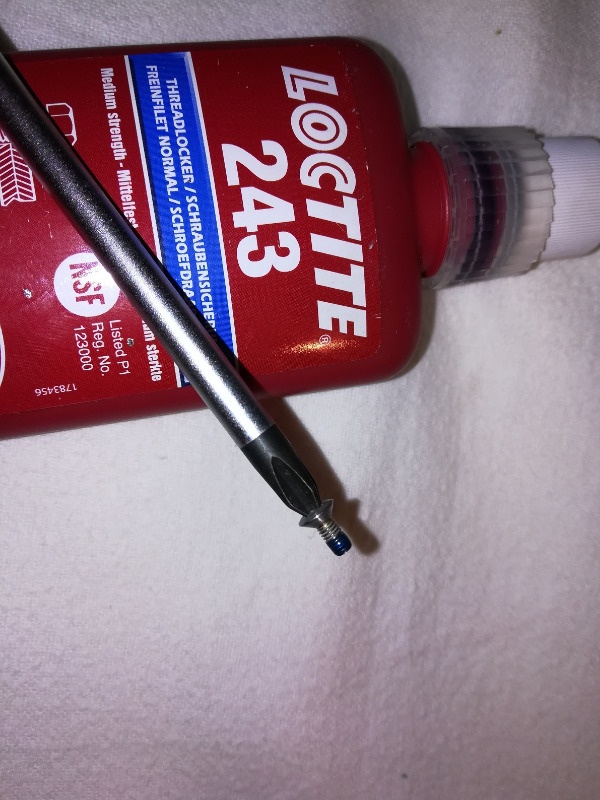

After that as the first step, the assembly of the butterfly valve, with new seals and using loctite 243 thread locker on the screws. Putting the butterfly valves in the shaft slot is difficult at minimum, it requires concentration and steady hand, (if you tired don't do it), return spring must be hanged AFTER you put the screws in both valves. In later stage, while sliding the plates in the slots when about 90 percent of it is in the slot it self, you should move the shaft left and right slowly, repeatedly, with no pressure at all while very very lightly closing throttle in order to set the plates to fit the bore of the venturi (that's the difficult bit) and when they are in, you need to center the holes for the screws (they should already almost fit) almost in the middle for both holes in both valves. Verify the fitment of the plates (by looking through the venturi to the light) before putting screws in and hold the valves closed with the finger on the lever. Next steps: Plastic washer, circlip, and the cap (cap only once, on the left and right carb body) and than so hated leaky needle valve, holding plate, and microscopic size retaining wire clip, emulsion tubes, main jets, idle jets, the plug screw (everything proper clean), float plus pin, finally the float bowl. You done.

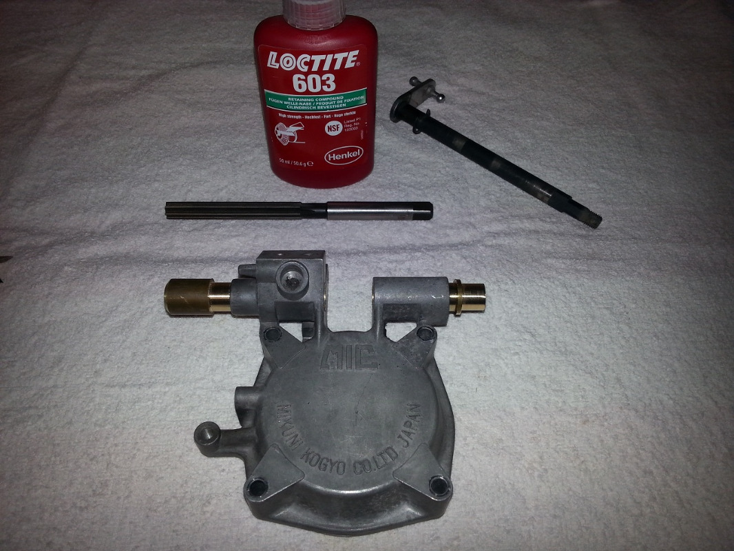

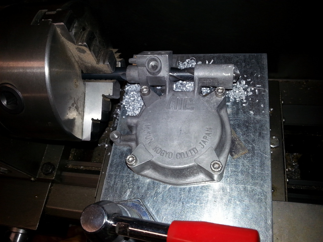

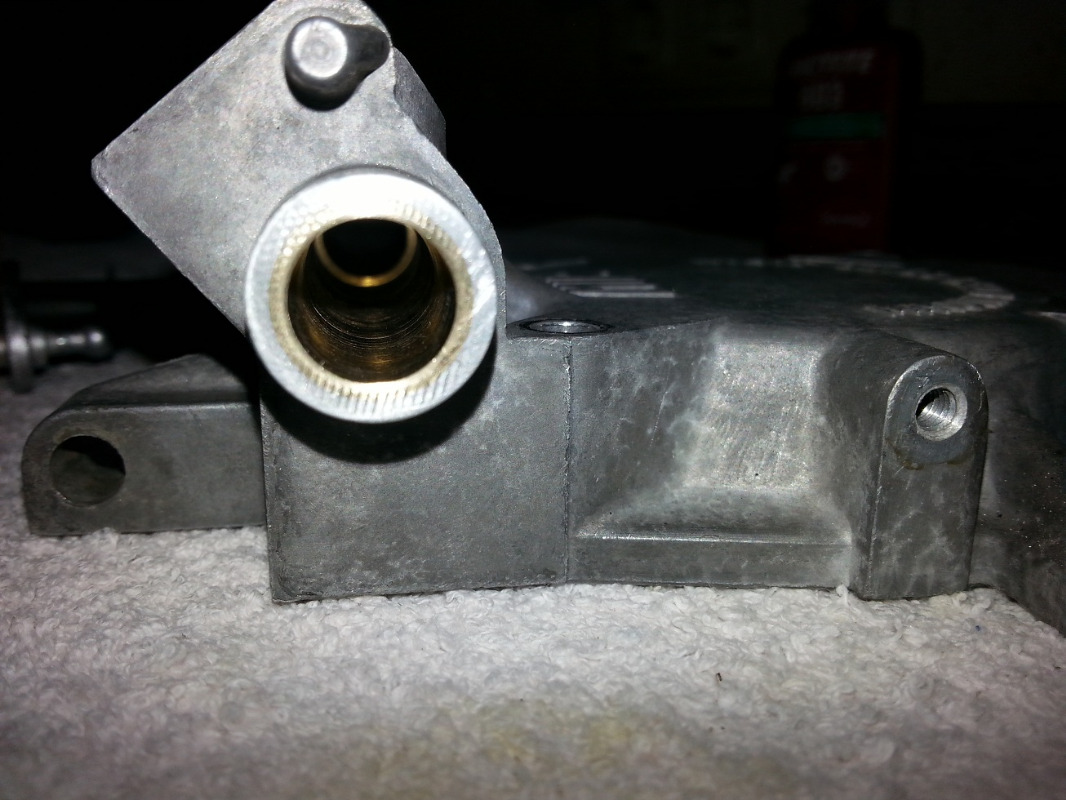

Now to the top, first thing I have notice was when applying choke (fast idling cam action), on the left side of the carb link rod was moving down more than the right one, due to play the linkage shaft has developed in relation to the cap. Repair was more or less straight forward, drilling out the bore, making and fitting brass insert using loctite 603 and than reaming the hole to the size and putting all the parts of the pulley together again. Than goes the membrane and slides with needle set to standard spec at first, (circlip in third notch counting from the top or bottom if you have needle with 5 notches, some of the first needles have had only one notch) and finally the cap with four new hex screws, on the left side enricher, membrane with spring, seat and cover. That's one of three carburetor done.

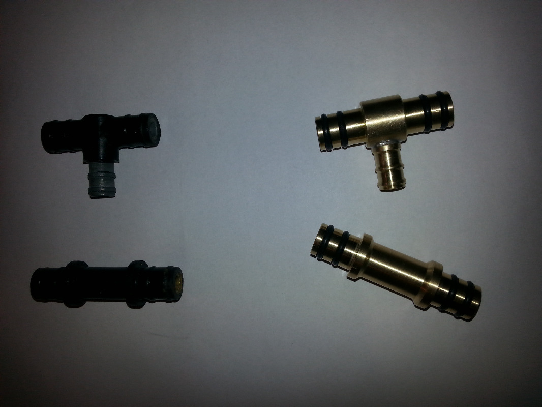

Also while I had them parted I have made new fuel connectors out of brass and with viton o rings (size 7x2 mm). T part is made out of two parts obviously and soldered together using hot air gun.

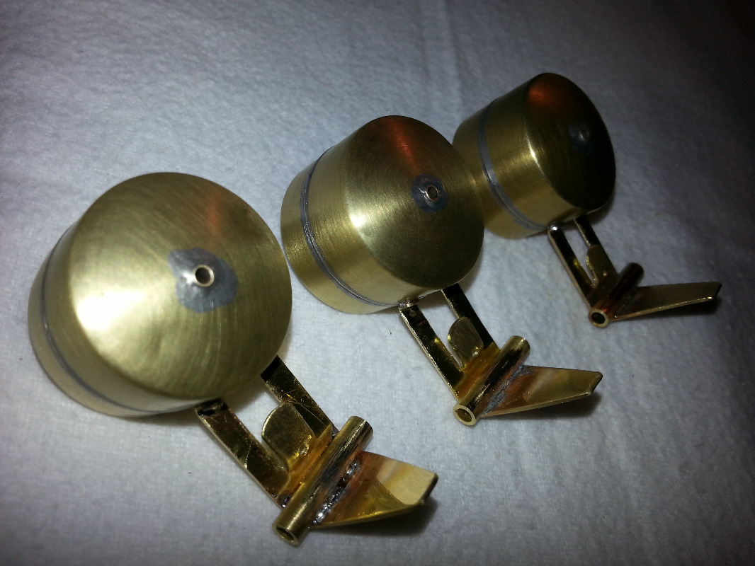

After i have read the article about carburetor restoration written by Scotch, l build those brass floats, the bodies are coming from bing 32 carburetor if i remember correctly and the arms i made out of brass stripe using the jig.

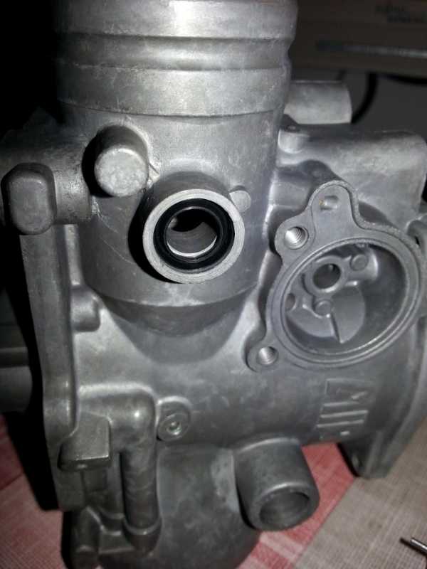

I forgot to add, the choke plungers have got now also new viton seal made out of viton sheet.

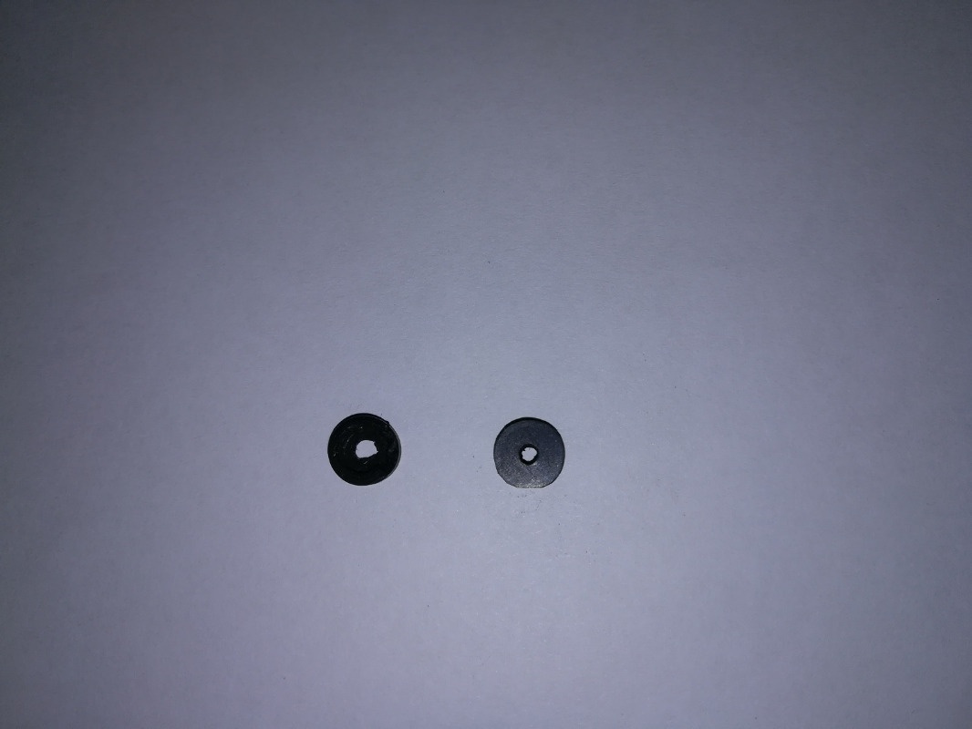

The Man's got tools and the talent to use them. Nice work !! It will be interesting to see how the floats work out for you. Different shape than Scotch's.

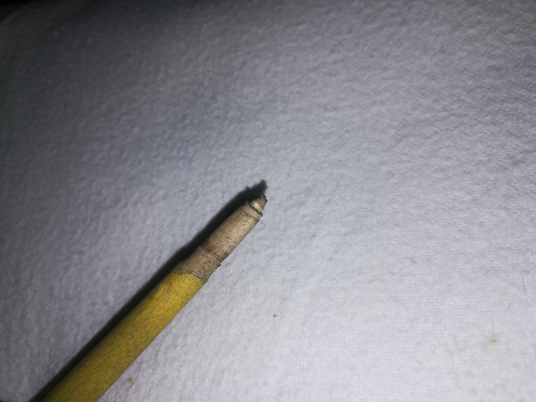

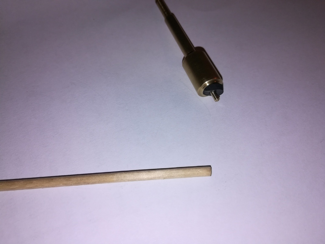

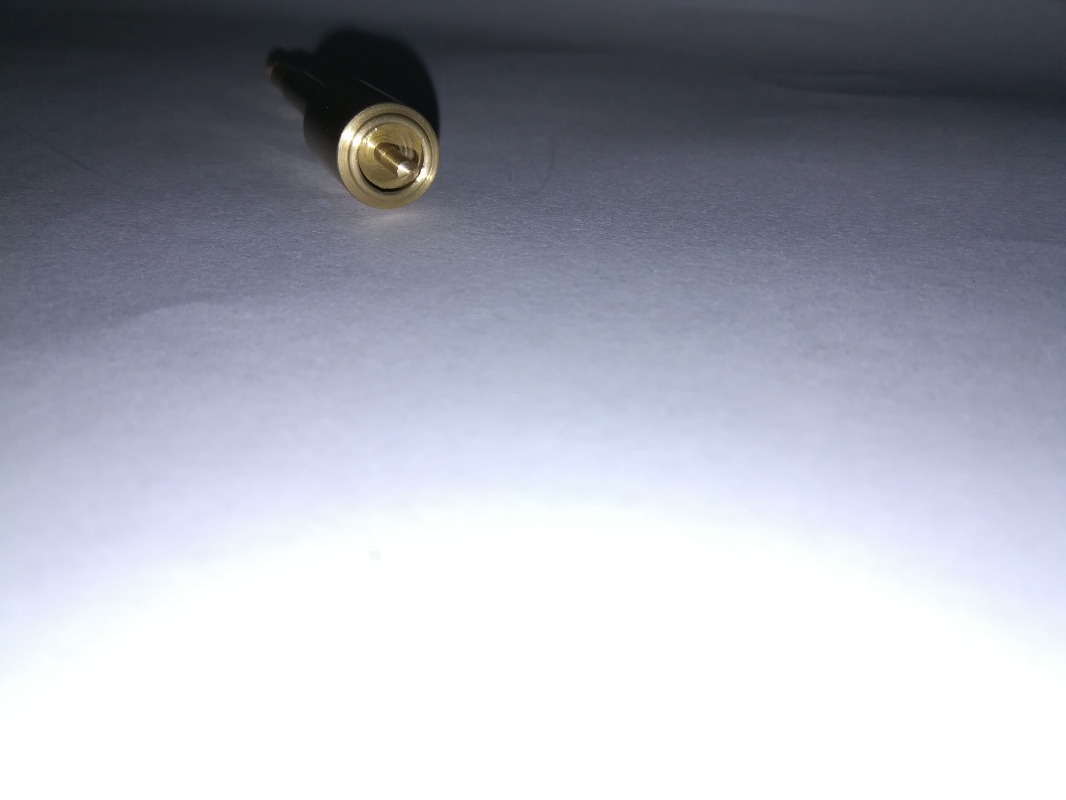

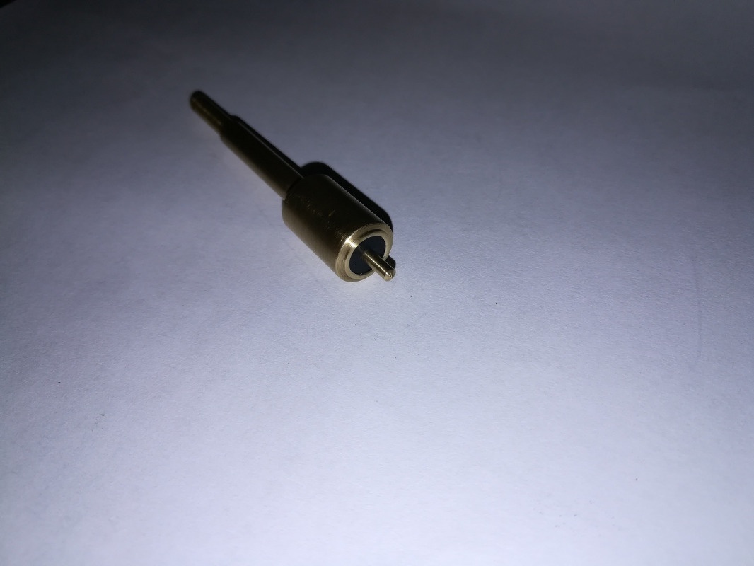

Kawboy my floats are ok, the function of them leave nothing more to desire i never had float valve leak with them, also while using original floats due to properly polished seat inside of the float valve body. Here the picture of the stick i use to polish the seat. Its a handle from small round brush and its made of some hardwood. Also here the link to video of me making the floats. I did them because i want it to have my own floats in carbs as a spear alternative in case i needed one. Or i could have simply bought them from Scotch, but I'm more of this DIY guy, ya know.
