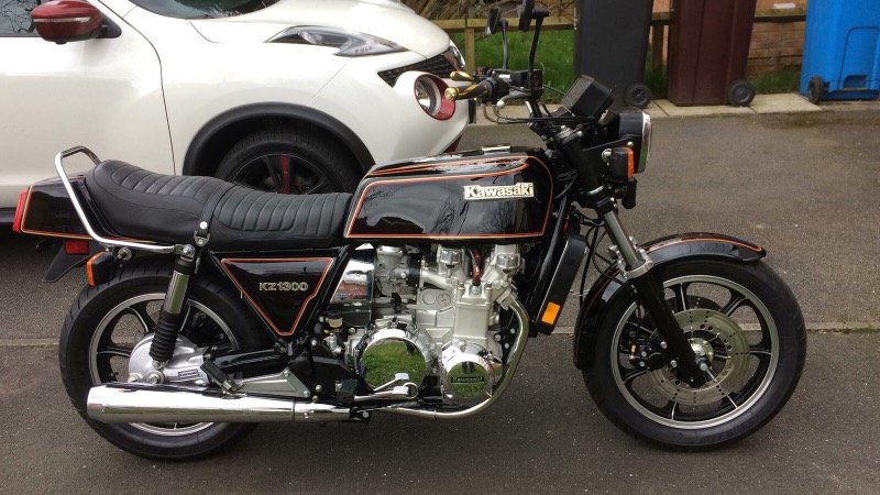

I know its been covered before on the forum, but my Z13 is again refusing to start after she's been stood for a few days, but after a few minutes of hot air on the carbs from the wife's turbo hair drier, she quickly fires up on 2, then 4, then 6 - then settles into a normal tickover and runs perfectly: well, until she's left again for a few days :S
Pretty sure one of the wise sages from these hallowed pages (maybe Scotch or Kawboy) did provide an explanation previously, but I cant seem to locate it. Any advise genuinely appreciated as its really annoying and I would love to banish the gremlin once and for all. Oddly, if I remember to start her every 2 or 3 days it never happens, and once started the bike runs pefectly thru the entitre rev range.
