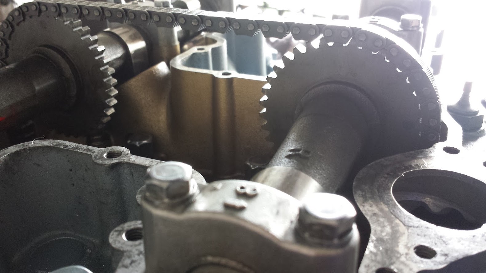

Anyway, cams are now installed and timed!
https://lh6.googleusercontent.com/a6cjbVfsZuAjUoW__xSCleiXDZt2phgkBX30h9SFrET_=w1580-h889-no

[quote="brandonsmash" post=9146
[/quote]
Something looks wrong in that last picture, the chain is not seated on the drive gear for the exhaust cam, maybe that's not a final picture or something. If you can still see light between the chain and gear something is not right.
[/quote]

11 years 1 month ago
In that last photo I've neither installed the cam chain tensioner nor bumped the crankshaft to set the chain in the gears. As it stands there are 17 links between the timing circles on the exhaust and intake cams, so everything just needs to be tensioned. Good eye, though.
