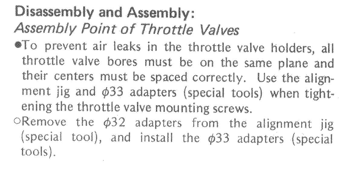

When you reinstalled your throttle bodies did you use the special Alignment Jig tool (57001-1036) or ???

I believe this is for carburetor bikes to check the fuel level
the voyager is injection system

5 years 10 months agoClintsMotorcycles wrote: When you reinstalled your throttle bodies did you use the special Alignment Jig tool (57001-1036) or ???
and the KZ1300 Service Manual Section 6 page 5 says.....

Kawboy,
is this also for the Voyager with DFI system?

I think it applies to both the carb and the DFI version.
However, I think I miss read it. I removed my injectors by loosening the clamps that tighten the rubber grommets between the manifold and the injector bodies. Then, I just pulled all three injector bodies off as an assembly. I *think* what the manual may be referring to is that there is a metal piece on top of the injector bodies that has a bunch of screws in them to tie all the injector bodies together. I guess if you disassemble them into individual injector bodies they can get out of alignment with the manifold. But, if you leave them as an assembly, as I did, I think I am OK. Can anybody confirm that? I cannot find that special tool anywhere.

OK, make sense now, I didn't take the bodies apart.
I just took out as complete unit and install them back after cleaning, didn't have any issue
the fuel hoses sometime get dry and break specially if the bike was not in use for a long time.
