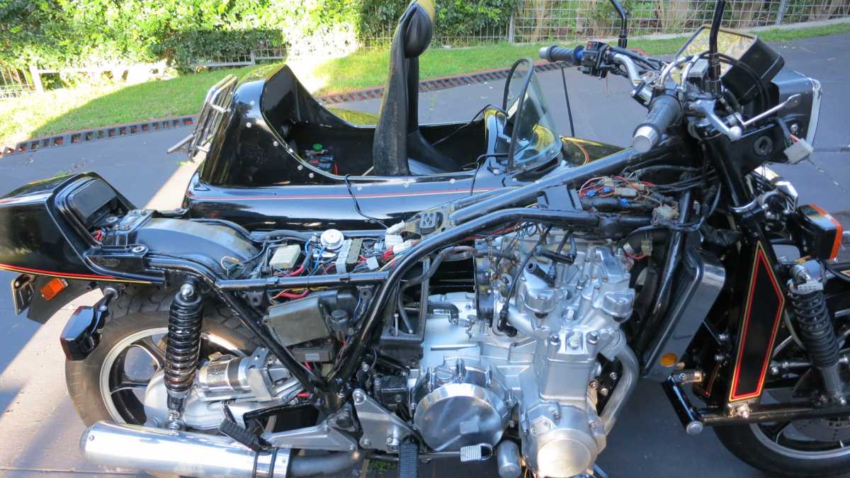

Sidecars are not always a problem - You can just undo a few bolts and Bob's your uncle, sidecar removed right? Well not always and this is not a complaint by me, just letting you know the differences. So located in the sidecar is: -
The bike itself has an electric motor on the right hand side, down by the back wheel that turns a spindle that is actuated by a handbrake like mechanism (between the bike and the sidecar) that moves the spindle hard onto the tread of the back tyre whereby the electric motor turns the spindle and the bike reverses (deep breath). I don't use it any more but it is still there.

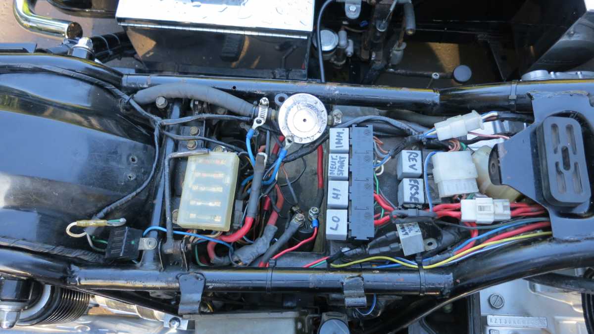

There is no tool tray and where the original battery used to be is all wiring and two solenoids (one is supposed to provide a boost for starting). The rest of the switches are located on a steel plate that screws down onto the top of the air filter housing. There are spare wires here and there not being used (some of them live) and I presume that the wiring here is unlike any other Z1300.

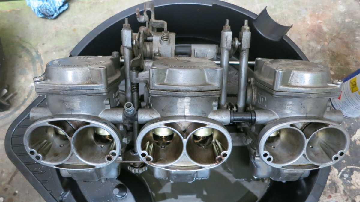

- Removed and cleaned the carbs

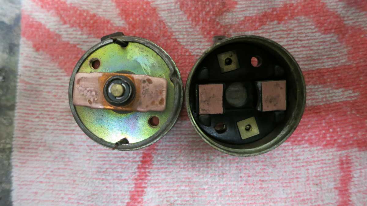

- Removed, cleaned and tested the starter motor

- Sorting out the starter motor (failed test)

- New o rings for carbs. Still trying to source them.
- Reconnect the carbs (nervous breakdown time :blink: )

In the last photo, is that the rear brake pedal, the round thing on the end of the long shaft from that master cylinder in front of the toolbox ??, just wondering, wow the last owner sure added a lot of stuff, mines very bare, only wires going to the chair is for the extra stop/tail light and side light, last chair I had I did put a "nudge bar" on the front welded to the chair frame and mounted a spot light hooked up to the high beam, and I had a really posh stereo FM radio with 2 speakers in the chair
, we are talking the early '80s
, was thinking of a spare battery in the chair also, but after I fixed the starter, the on board battery works well, bike starts as soon as I touch the button, guess i'm a minimalist, less on there, less to go wrong, cheers Pete.

Hi Pete, it is a foot brake that doubles as a parking brake except the brake is on the sidecar wheel. It was one of the most useful upgrades to the bike in my opinion. When I rode the bike a lot I used it to help steer the bike around left hand bends, but only used as a parking brake these days.
